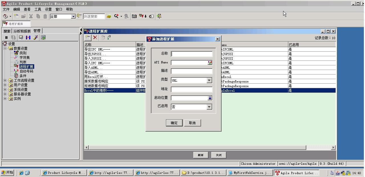

Configuring Custom Action in Agile Java Client   在Agile Java 客户端配置用户操作
‍In Agile Java Client,you can define custom action in the Admin module.To configure Agile PLM system settings,you must log in as a user with adinistrator privlieges.
在Agile Java 客户端,你可以在Admin 模块中定义一个用户操作。要配置系统设定,你必须以系统管理员权限登录。

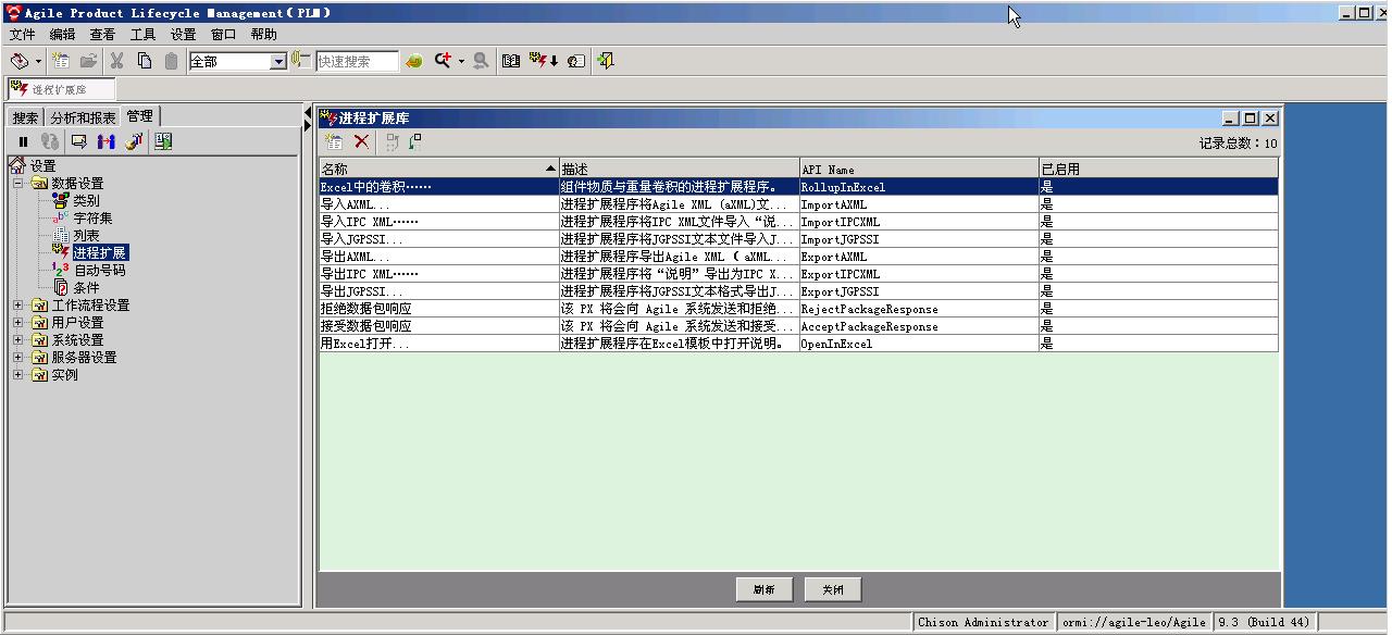

Using the Process Extension Library
‍The Process Extension Library is where you define the custom actions that can be used in Agile PLM client.When you add a custom action to the Process Extension Library, you specify how to initiate that action from the client.
进程扩展库是你定义的能在Agile PLM 客户端使用的用户操作的地方。当你添加了一个用户操作在进程扩展库,你要定义这个用户操作在客户端的哪里开始启动。
    1.Log In to Agile Java Client as an administrator
    2.Click the Admin tab
    3.Open the Data Settings folder
    4.Open the Process Extension node
    5.In the Process Extension Library window,click the Add Process Extension button to open the Add Process Extension dialog box
    6.Type the folowing information     输入如下信息
       Name -Type the name of the process extension.    名称-输入进程扩展的名字
       API Name- This field is automatically filled in after completing the Name field. 应用程序接口名-这个字段当完成名称字段后自动填充
       Description-Type a brief description of the process extension. 描述-输入一个关于这个进程扩展的概述。
       Type-Select Internal Custom Action. This activeates the Internal Custom Action fileld.
         类型-选择内部用户操作。
       Initiate From -Select one or more location from which the process extension can be initiate. Choose from the following options:
       启动位置-选择一个或多个进程扩展可以启动的位置,从以下选项中选择:
                Action menu -Allows you to selet the custom action from the Action menu of a properly configured class.
               操作菜单-允许你选择用户操作从操作菜单。
               External report-Allows you to generate a report by accessing an external resource or URL.If the process extension is an internal custom action, the External Report option is unavailable.
               外部报表-允许你通过访问外部资源或这网址来产生一个报表,如果进程扩展是一个内部客户操作,这个外部报表是不可用的。
                Tools menu -Allow you to select the custom action from the Tools menu .
                工具菜单-允许你从工具菜单中选择一个用户操作。
                Workflow status-Invoke the custom action whenever a properly configured wokrflow enters a particular status.
                 工作流状态-当符合设置的工作流状态时调用用户操作。
                If you specify that a process extension is initiate from the Actions menu or a workflow status,you can configure subclass or wokrflows to use it. If you specify that a process extension is used to generate an external report,you can use Agile Web Client to create the report. If you specify that a process extension is initiated from the Tool menu ,it's available all times in the Agile PLM client.
               当你定义一个进程扩展从动作菜单或者工作流状态开始启动时,可以用一个子类或者一个工作流来使用它;
                当你定义一个进程扩展用来产生外部报表,你可以使用Agile Web客户端来创建报表。
               当你定义一个进程扩展用来从工具菜单启动,那么他可以在Agile PLM客户端所有时间可用。
  Roles-Select one or more roles to use for the cutom action . To use the roles and privilege of the current user,leave this field blank.To temporaily overide roles and privileges of the current user,select one or more roles . Once the custom action is completed ,the client reverts to the current users's roles and privileges.
     角色-选个一个或多个使用用户操作的角色。这个字段不选默认使用当前用户的角色和权限。选择一个或多个角色可以覆盖当前的角色和权限。一旦用户操作结束,客户端会恢复到当前用户的角色和权限。
     Enabled-Select Yes or No. 现在可用 -选择是或否。
